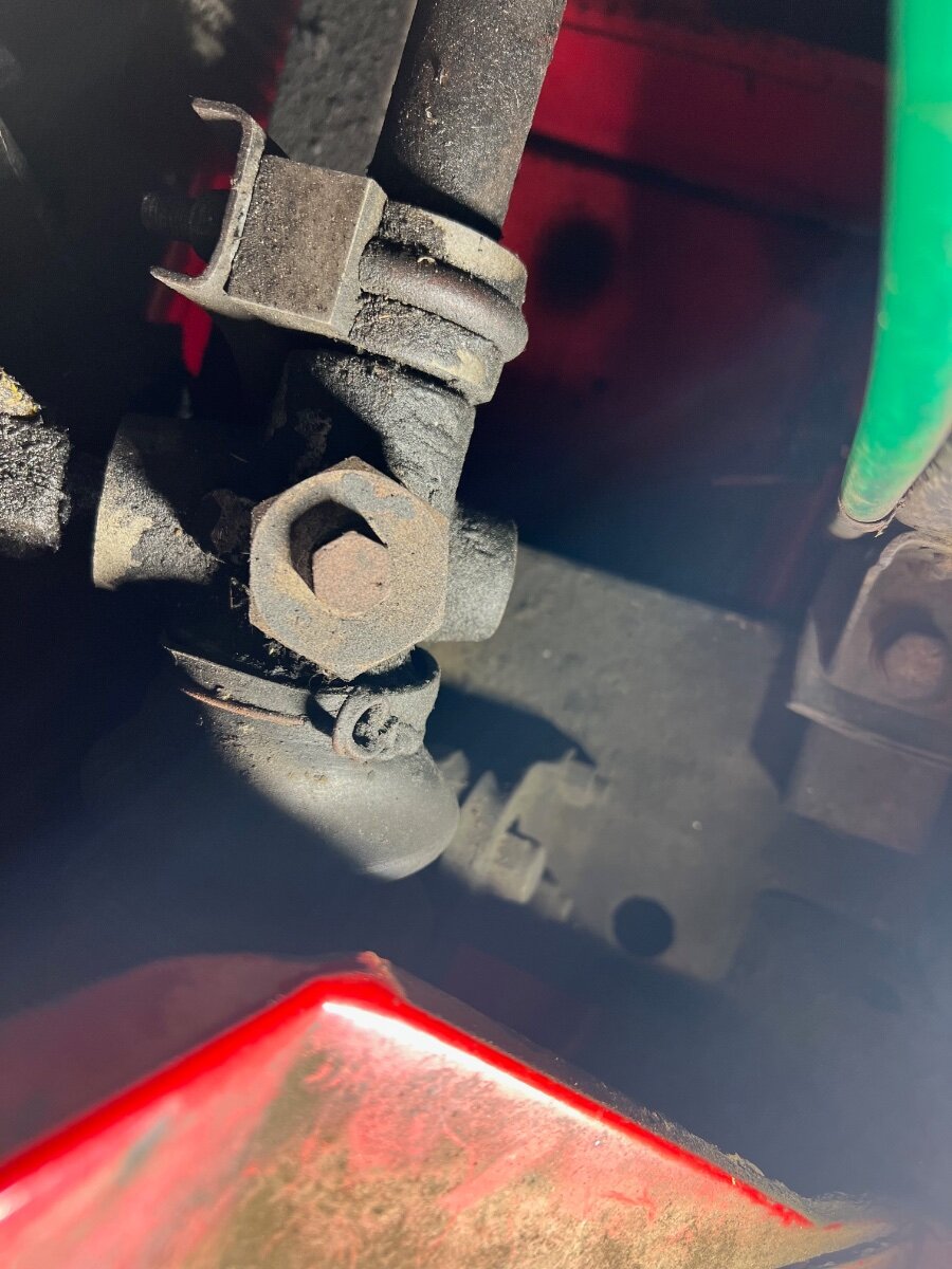

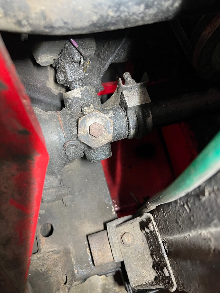

stuart Posted September 4 Report Posted September 4 14 hours ago, trevor said: The steering rack has a blanking off bolt that you need to put a nipple in to grease it. Only if its an original rack otherwise its sealed for life. Stuart. Quote
earckens Posted September 4 Author Report Posted September 4 1 hour ago, stuart said: Only if its an original rack otherwise its sealed for life. Stuart. Hi Stuart, I am not sure what date mine is; where should I look at on the steering rack to find this out? Quote
stuart Posted September 4 Report Posted September 4 (edited) 15 minutes ago, earckens said: Hi Stuart, I am not sure what date mine is; where should I look at on the steering rack to find this out? If you look at the top of the rack where the column enters it there is on the repro racks just a sort of bung thats peened over. An original rack has a large nut on the top and there is usually a grease nipple in there. Stuart. Edited September 4 by stuart Quote
trevor Posted September 4 Report Posted September 4 As Stuart says , mine was a new old stock rack even came with a Stanpart label. Quote
