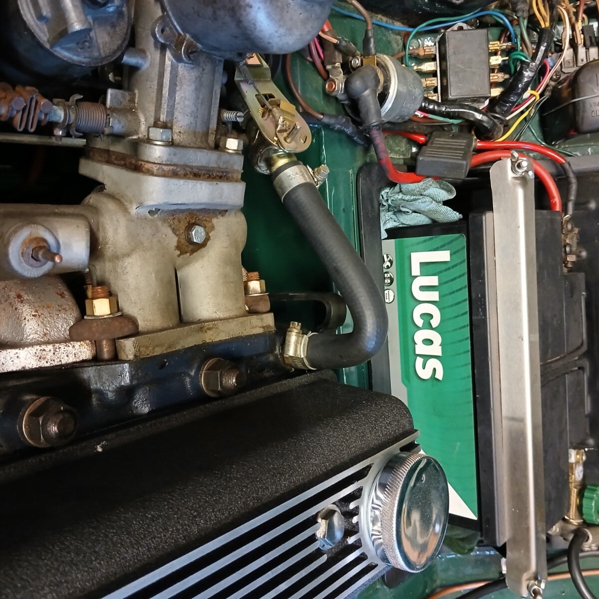

Ralph Whitaker Posted September 15 Report Posted September 15 I used the much cheaper inline taxi valve, a straight connector in the head, and another right angled heater pipe. Works well and plenty on Ebay for around a tenner, Quote
stuart Posted September 15 Report Posted September 15 2 hours ago, Ralph Whitaker said: I used the much cheaper inline taxi valve, a straight connector in the head, and another right angled heater pipe. Works well and plenty on Ebay for around a tenner, On a sidescreen car thats actually a better option. I fitted the same to Martins (Distributor doc) car. Stuart. Quote

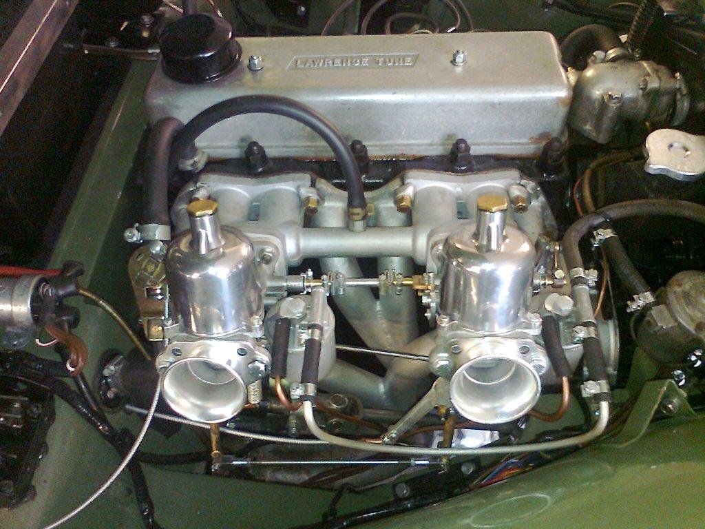

stuart Posted September 15 Report Posted September 15 9 minutes ago, Hamish said: Nice rocker cover too Rare piece, only one Ive ever seen. Stuart. Quote
