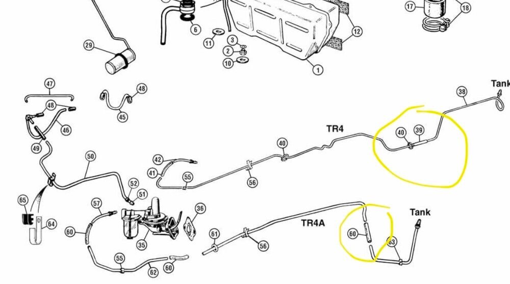

stuart Posted September 18 Report Posted September 18 (edited) Check flexible fuel pipes up to the pump Marco, should be one at the rear between hard line out of the tank to the chassis hard line and then one at the engine bay from the chassis hard line to the short feed to the pump. Possibly one is collapsing and restricting flow? Stuart. Edited September 18 by stuart Quote
BlueTR3A-5EKT Posted September 18 Report Posted September 18 6 hours ago, stuart said: Check flexible fuel pipes up to the pump Marco, should be one at the rear between hard line out of the tank to the chassis hard line and then one at the engine bay from the chassis hard line to the short feed to the pump. Possibly one is collapsing and restricting flow? Stuart. Something tells me some other forum user had identical problems. It turned out to be as you state Stuart the inside of the flexible fuel lines collapsing. (Ethanol fuel?) That prompted me to renew all the flexible fuel lines in my car with Gates Barricade ethanol proofed flexible hoses. Quote
Hamish Posted September 18 Report Posted September 18 (edited) I had fuel starvation on my 3a snd it was a rear flex hose that joined 2 metal pipes not sure if the 4/4a is the same. I went for a huco elec pump which has the ideal pressure for su’s now on facet and pressure regulator with the webers Edited September 18 by Hamish Quote

stuart Posted September 21 Report Posted September 21 I did have a problem many years ago with a 250 on Webers that was fed by a Huco type pump in the boot, it kept burning pumps out, turned out after all the flexible hoses were replaced it was actually the front to back hard line that was nearly completely blocked as it was actually the lowest point of the system and the steel pipe although looking fine on the outside was corroding internally. Stuart. Quote
