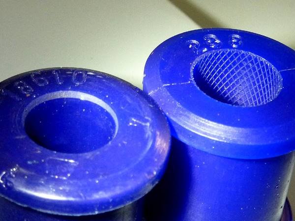

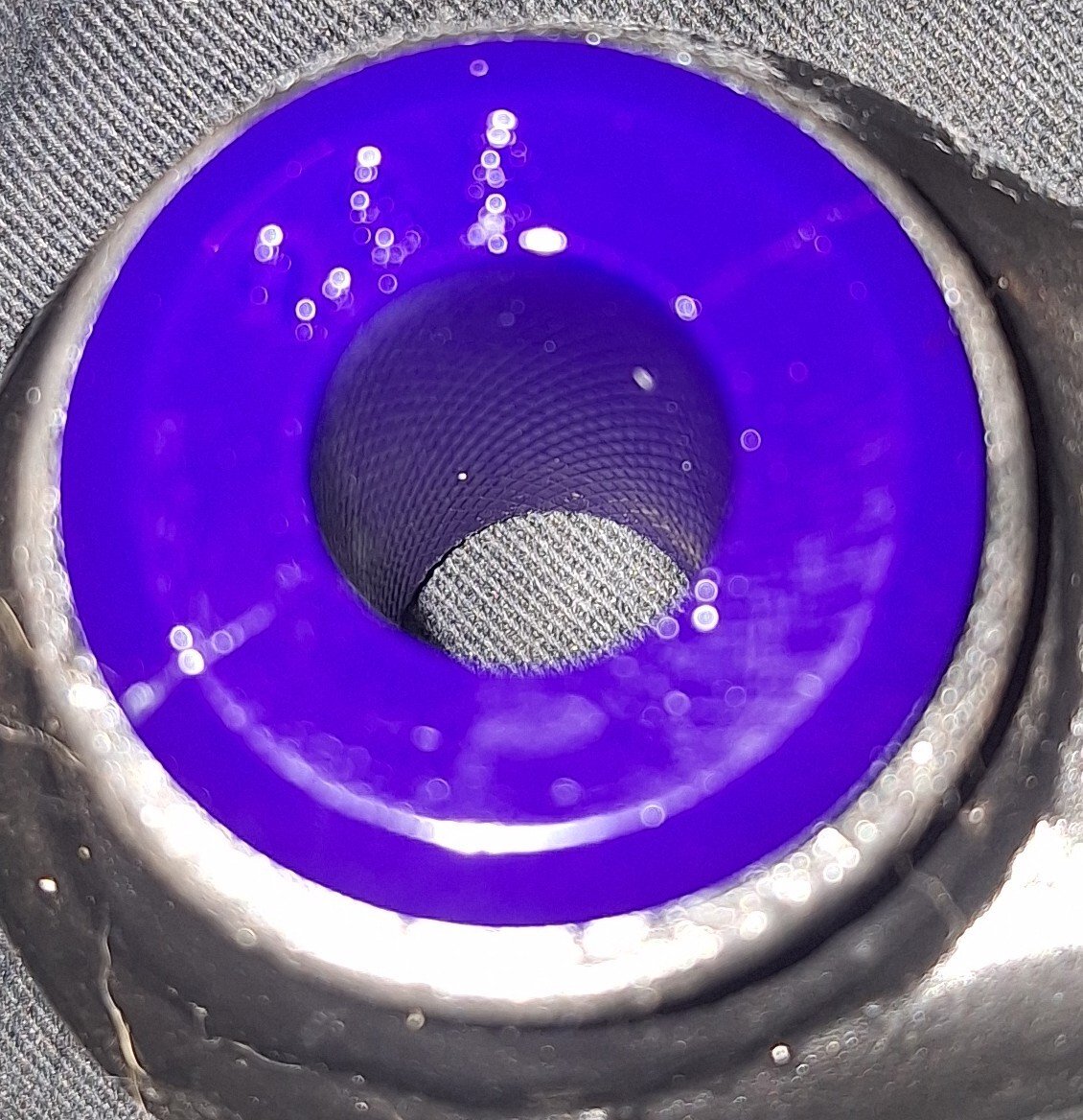

harrytr5 Posted Thursday at 07:08 PM Report Posted Thursday at 07:08 PM The lower inners on both superpro and superflex have inner sleeves. I have changed to Superflex when I saw Marcos post about them. The inner cross hatching to retain the silicon grease is a genius idea and the stainless sleeves a bonus. Regards Harry Quote
michaeldavis39 Posted Thursday at 07:44 PM Report Posted Thursday at 07:44 PM Harry- Superpro have the cross hatching on the inside too as shown in my photo Quote
Z320 Posted Friday at 04:49 AM Report Posted Friday at 04:49 AM Great to know, do they point on this feature? Quote

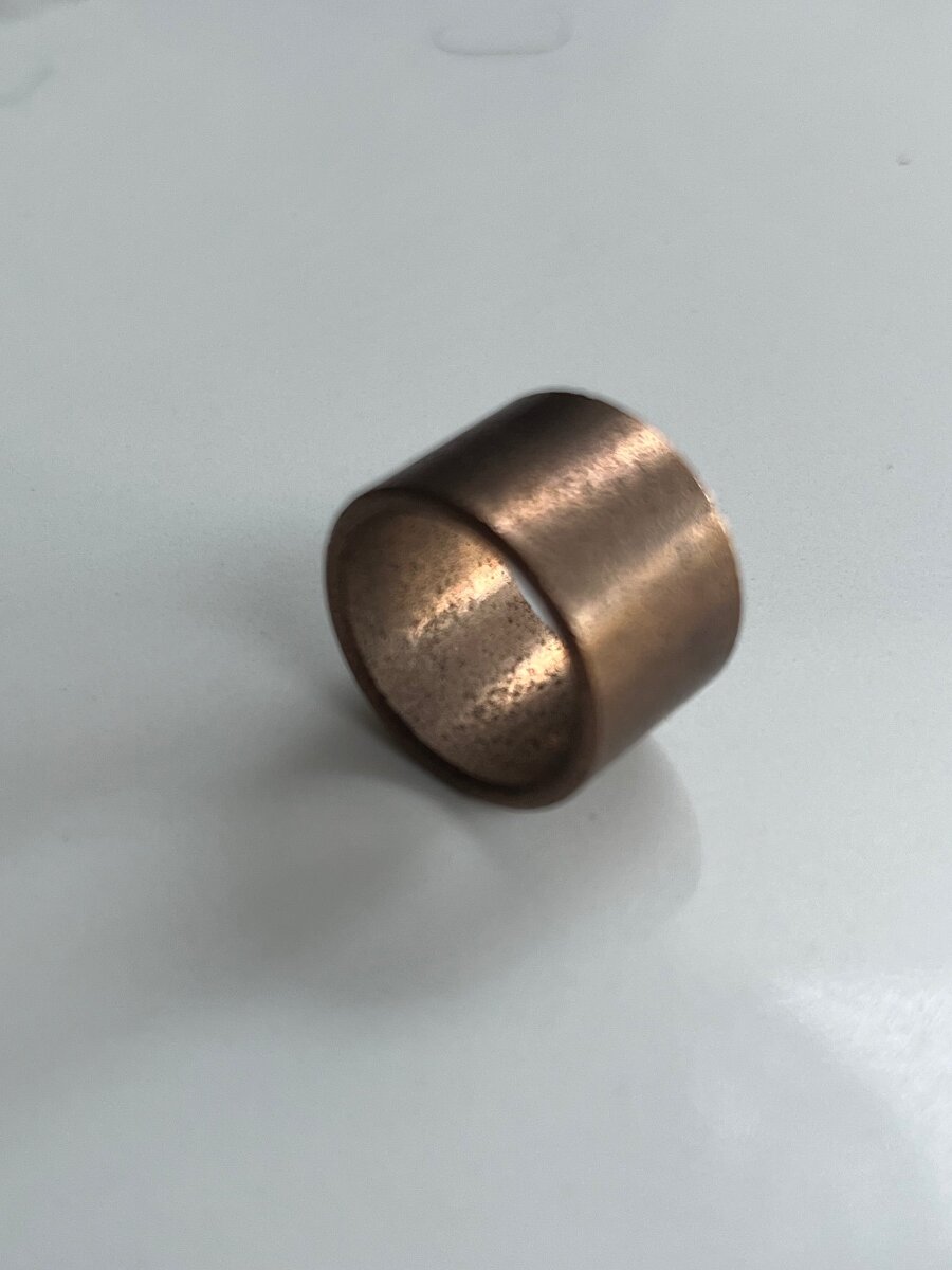

BlueTR3A-5EKT Posted Friday at 07:10 AM Report Posted Friday at 07:10 AM 15 hours ago, Lebro said: I'm thinking of doing a front suspension overhaul this winter, nothing wrong as far as I know except one trunnion squirts grease out of the base when trying to replenish it. (I did soft solder the base to the body, but a small crack has opened up) I currently have TR shop poly bushes in some of the locations,(don't know who makes them) but in case they are worn what is the current recommended make. I looked up superpro, but they only do the top inner ones, plus shocker's & antiroll bar, which is not really what I was after, rather both ends of bottom, & inner of top wishbones. Superflex seem to do more, & maybe I can get something at the NEC show ? Bob Your choice for lower outer bushes does not include polyurethane for a TR2-3-4 with a trunion that has a fixed pin. The options are original steel backed lined bushes that need reaming to 5/8" to suit the trunion pin once fitted or Oilite bushes. I do not know if Oilite need reaming. Quinten Hazel used to supply brass bushes, but I think they are now history. If you want some original bushes PM me as I have a few spares. Revington markets Oilite from the sintered oil impregnated bush making industry. Quote
Ben Davies Posted Friday at 07:28 AM Report Posted Friday at 07:28 AM I fitted the Oilite lower outer bushes from Revington - they didn’t require reaming. Quote

BlueTR3A-5EKT Posted Friday at 07:48 AM Report Posted Friday at 07:48 AM 19 minutes ago, Ben Davies said: I fitted the Oilite lower outer bushes from Revington - they didn’t require reaming. Were they drilled for the lubrication or was that task required after fitting? The use of Oilite is very sensible. Quote

Ben Davies Posted Friday at 08:19 AM Report Posted Friday at 08:19 AM 27 minutes ago, BlueTR3A-5EKT said: Were they drilled for the lubrication or was that task required after fitting? The use of Oilite is very sensible. Good question. I think they were pre-drilled. I bought an extra one just incase and will confirm next time I see it… Quote
BlueTR3A-5EKT Posted Friday at 11:37 AM Report Posted Friday at 11:37 AM (edited) 3 hours ago, Ben Davies said: Good question. I think they were pre-drilled. I bought an extra one just incase and will confirm next time I see it… Can you measure it for us too? We know tge bore is 5/8” so presumably the exterior is 3/4”. But what is the bush length.? https://www.simplybearings.co.uk/collections/oil-filled-bushings?_gl=1*30smtl*_up*MQ..*_ga*NzczMzIxODE0LjE3OTA5NDExMTI.*_ga_NNP108LS6F*czE3OTA5NDExMTIkbzEkZzAkdDE3OTA5NDExMTIkajYwJGwwJGg5NjgxNzk2MDA.*_ga_HM5RZGXBJW*czE3OTA5NDExMTIkbzEkZzAkdDE3OTA5NDExMTIkajYwJGwwJGgw&af[Inside+Diameter][]=15.88mm+%3D+0.625+(5%2F8)+inch&af[Outside+Diameter][]=19.05mm+%3D+0.75+(3%2F4)+inch This a link to the people who made (make?) the TR crank spigot bushes. https://bowman.co.uk/bearings/oilite-sintered-bearings/oilite-plain-bearings/ Edited Friday at 11:40 AM by BlueTR3A-5EKT Quote
Ben Davies Posted Friday at 11:38 AM Report Posted Friday at 11:38 AM 3 hours ago, BlueTR3A-5EKT said: Were they drilled for the lubrication or was that task required after fitting? The use of Oilite is very sensible. I’ve just remembered the answer… the bushes are shorter - each arm has two oilite bushes fitted to replace one standard bush. When pressed in, one from each side, there is a gap in the middle where the grease fitting is. So 8 of those needed in total if going down this route. Quote
Ben Davies Posted Friday at 11:39 AM Report Posted Friday at 11:39 AM Just now, BlueTR3A-5EKT said: Can you measure it for us too? We know tge bore is 5/8” so presumably the exterior is 3/4”. But what is the bush length.? This a link to the people who made (make?) the TR crank spigot bushes. https://bowman.co.uk/bearings/oilite-sintered-bearings/oilite-plain-bearings/ Yes I’ll find it and measure it when I get home. Quote
BlueTR3A-5EKT Posted Friday at 11:42 AM Report Posted Friday at 11:42 AM (edited) 4 minutes ago, Ben Davies said: I’ve just remembered the answer… the bushes are shorter - each arm has two oilite bushes fitted to replace one standard bush. When pressed in, one from each side, there is a gap in the middle where the grease fitting is. So 8 of those needed in total if going down this route. That makes sense if you are buying off the shelf standard sized bushes. Do you lubricate with oil? Edited Friday at 11:42 AM by BlueTR3A-5EKT Quote
Ben Davies Posted Friday at 11:48 AM Report Posted Friday at 11:48 AM (edited) 7 minutes ago, BlueTR3A-5EKT said: That makes sense if you are buying off the shelf standard sized bushes. Do you lubricate with oil? Yes. Soaked in a jar of engine oil for a day or two before fitting. Though I think they’ve been greased since. Wonder if oil in the gun would be better… I recall they were about 1/2” in length. Will confirm later… Edited Friday at 11:49 AM by Ben Davies Quote
Ben Davies Posted Friday at 04:52 PM Report Posted Friday at 04:52 PM Found it! Dimensions are 5/8” ID, 3/4” OD and 1/2” in length. Quote
