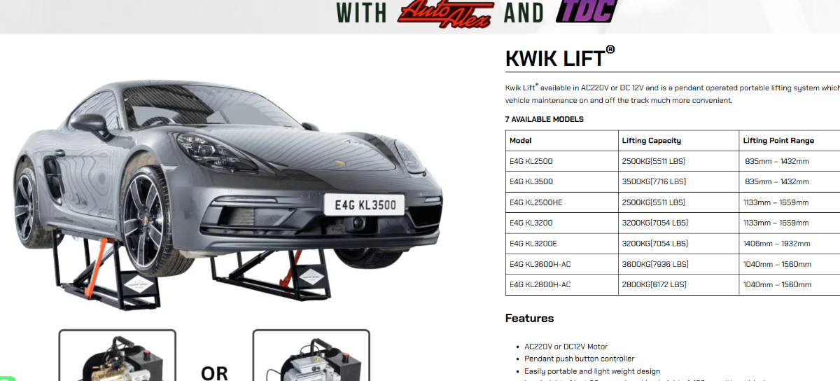

Paul Hig Posted Saturday at 08:18 AM Report Posted Saturday at 08:18 AM (edited) I use "quick Jack" units which give you 90% clear access underneath. Bit of a fiddle to line up, but then rally good and stable. Can also store on wall brackets when not required Kwik Lift: Portable Car Lifting Quick Jack System. E4G KL2500 and E4G KL3500 - Kwik Lifts® Fast, Safe & Portable Low Height Car Lifting Solutions Edited Saturday at 08:19 AM by Paul Hig Quote

Mike Morris Posted Saturday at 08:38 AM Author Report Posted Saturday at 08:38 AM 19 minutes ago, Paul Hig said: I use "quick Jack" units which give you 90% clear access underneath. Bit of a fiddle to line up, but then rally good and stable. Can also store on wall brackets when not required Kwik Lift: Portable Car Lifting Quick Jack System. E4G KL2500 and E4G KL3500 - Kwik Lifts® Fast, Safe & Portable Low Height Car Lifting Solutions Only lifts about .5m though Quote

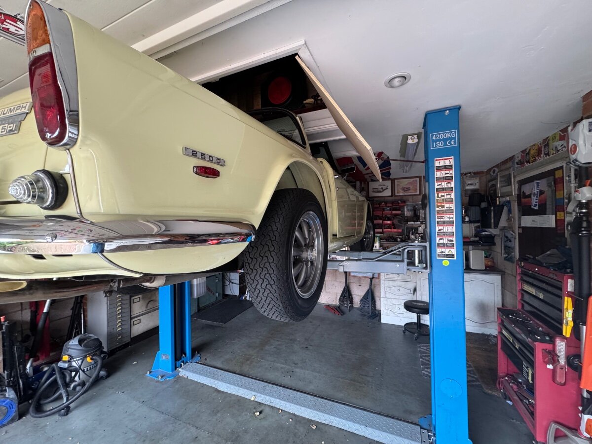

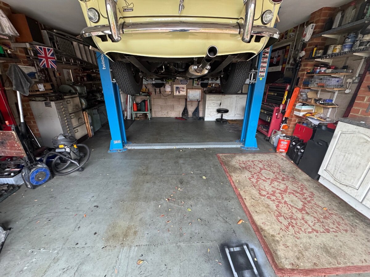

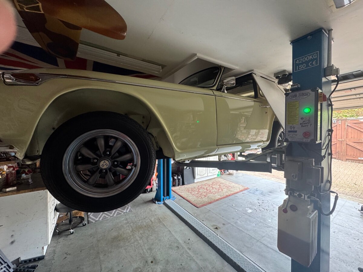

harrytr5 Posted Saturday at 09:56 AM Report Posted Saturday at 09:56 AM 3 hours ago, Mike Morris said: https://automotechservices.co.uk/products/as-230nsp-3-0t-capacity-short-narrow-2-post-lift/ After several days where I have spent my day contortioning my body into shapes it shouldn't, I have decided to buy a lift. Looking at scissor lifts, you have restricted access underneath. With the 2 post, you have full access. Thinking off buying the low height above which will lift the car 1.5m Anyone got/used one? Yes had mine installed around ten years ago. Could not do without it now. Mine has the company name as Busch but looks the same. The concrete should have a minimum of 200mm in depth and mine was 150mm with reinforcing bars in the concrete which allowed the company to fit it and gave me a certificate to say it conforms.They do a reinforcing support plate to spread the load over a bigger area if needed I paid £500 for them to install and well worth it as the metalwork is very heavy. I cut two letter boxes in so I got maximum lift and can whizz around on a Halford wheeled stool. You are welcome to have a play if you are undecided. I am in Hemel Hempstead. Regards Harry Quote
harrytr5 Posted Saturday at 10:06 AM Report Posted Saturday at 10:06 AM P.S. I changed the shorter arms to match the longer ones supplied to enable me to use it better as our cars are quite narrow. Pm me if you want more info. Regards Harry Quote

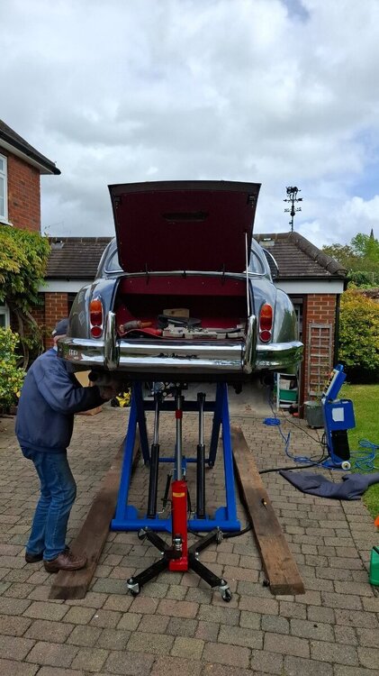

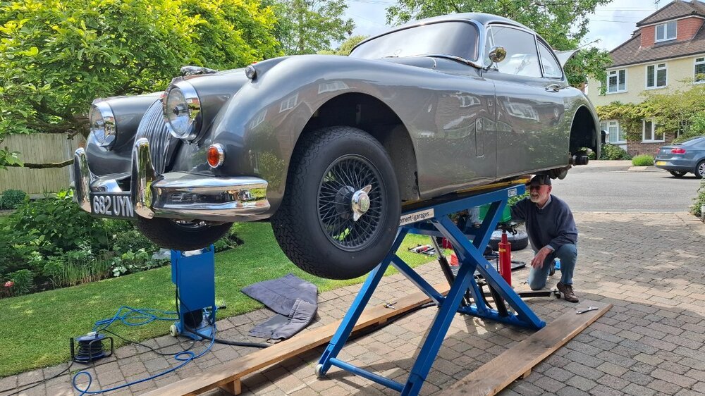

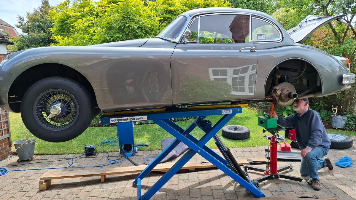

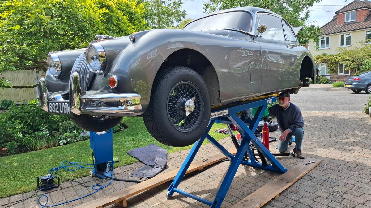

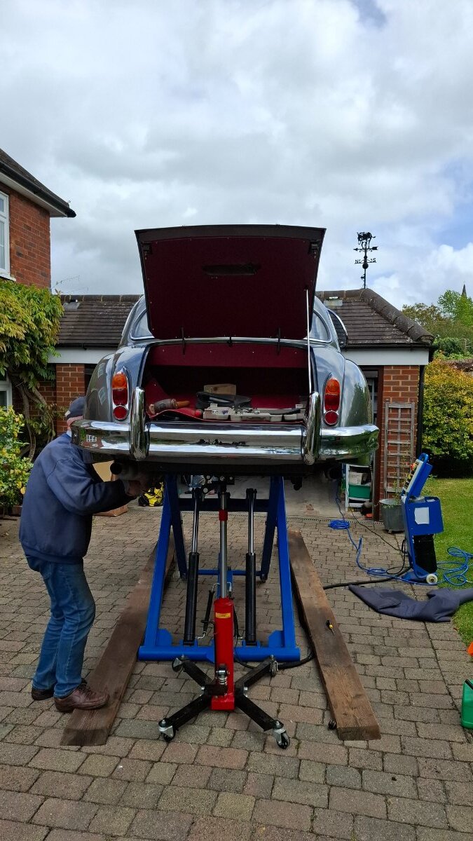

wheeler Posted Saturday at 12:15 PM Report Posted Saturday at 12:15 PM In defence of the scissor lift, I bought one about 10 years ago and don't find it obstructs work to much. You don't have to worry about floor fixings and you can move it around and use outside the garage 1.4 M lift height. I would not be without it. Photos show my friend removing his petrol tank ftom his Jaguar XK150. Bill Quote

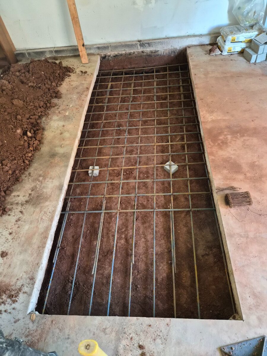

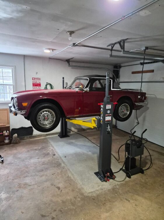

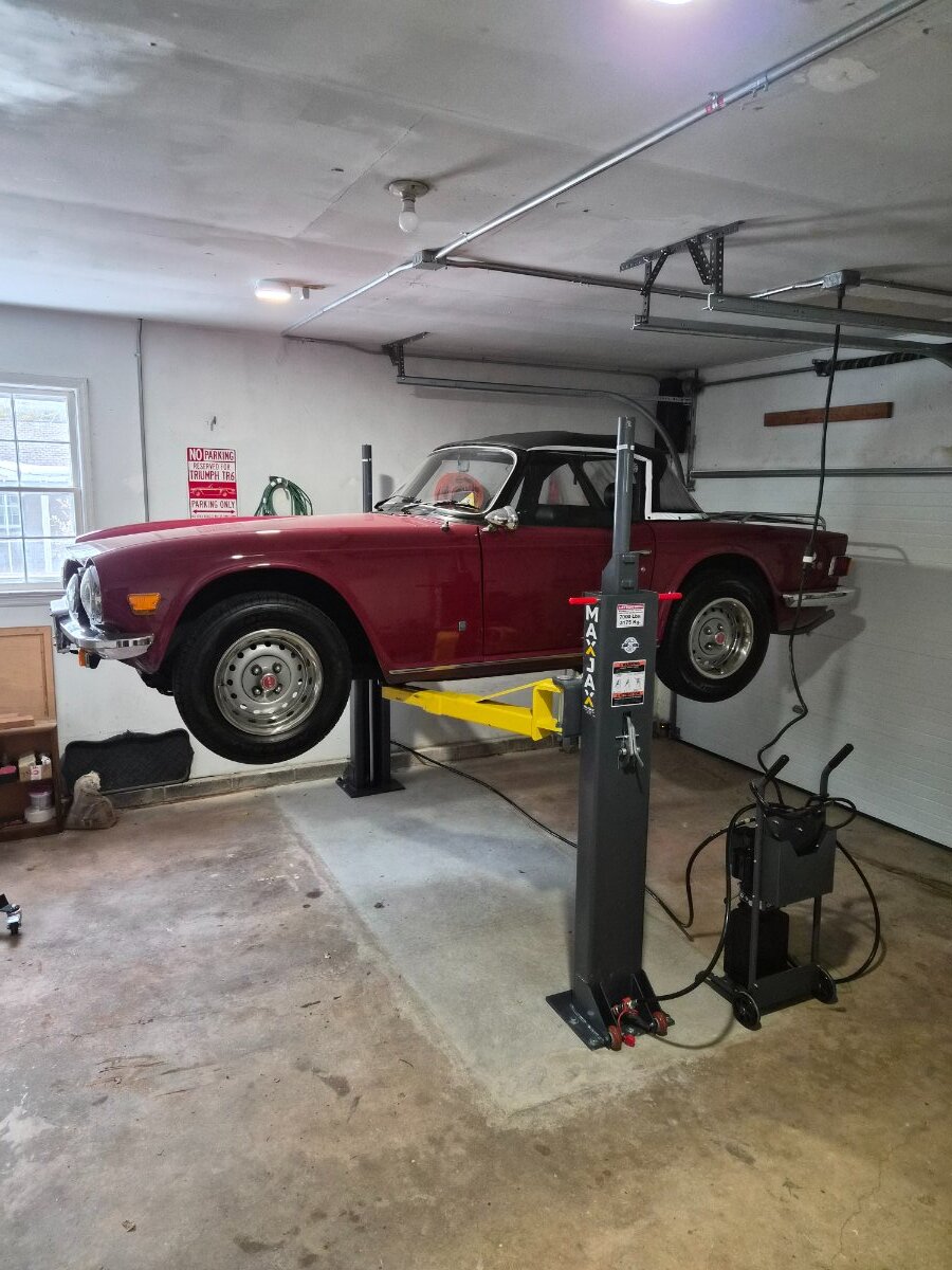

Magz Posted Saturday at 08:04 PM Report Posted Saturday at 08:04 PM (edited) I went for the MaxJax 2-post lift. First I had a mason dig up the floor and pour a 12" deep section of fiber-reinforced concrete, further reinforced with steel rebar. The lift gets up high enough for me to roll under it on a stool. The posts can also be unscrewed from the floor and rolled to a storage location, but I just leave them in place. It's really a godsend...I would not be doing nearly as much work on the car if I had to lie on my back under it! Edited Saturday at 08:08 PM by Magz Quote
