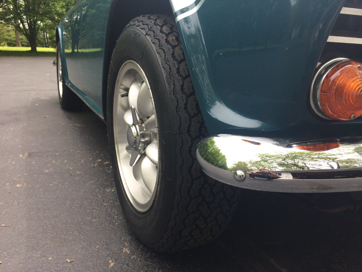

Tom Fremont Posted September 18, 2023 Report Posted September 18, 2023 I ran 195/65 Michelin Pilot Exaltos for 40K miles on my driver '250 and found that (1) ~ 1/2" of tread didn't touch the pavement at 25psi and (2) they are actually smaller in diameter than the 165/80s. I have been happy with 185/70 Michelin XWX since then, now on my 2nd set. They only went about 25K miles the first round, edges wore first so am inflating them to 26/28 now. Quote
