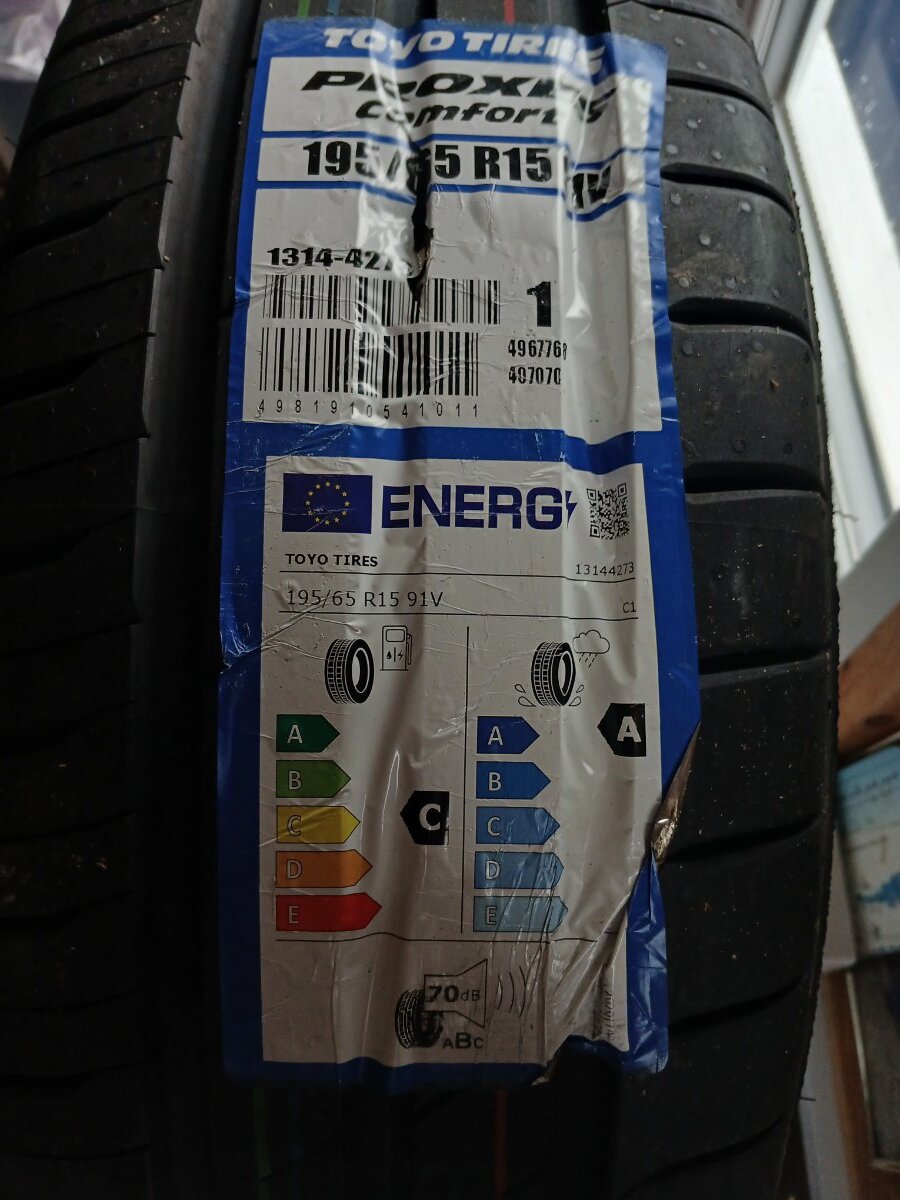

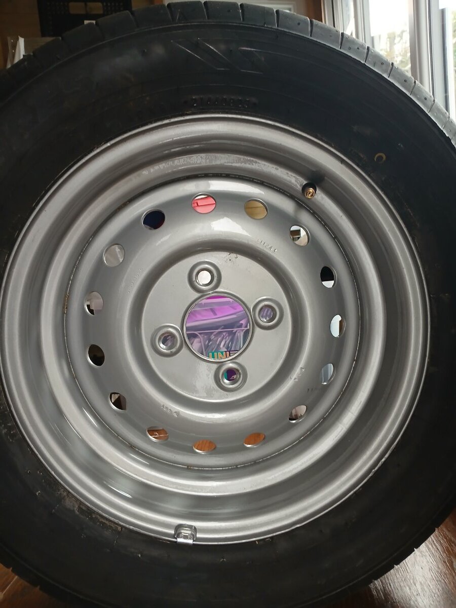

Clive Brown Posted April 15, 2025 Report Posted April 15, 2025 My 6 has a brand new wheel and 195/65/R15 Toyo proxy comfort tyre spare. Which doesn't fit in the spare wheel apature in the boot. Looking for same condition wheel and tyre setup that does fit. Or even a full 5 wheel swap Please wait while image is uploading... Quote
wheeler Posted April 15, 2025 Report Posted April 15, 2025 Hi Clive I had the same problem with 195/65/R15 tyres including my spare. I just changed my spare wheel tyre for a 165/65/R15 which fits the spare wheel well, and in the case of a puncture to be used like a modern space saver ie just to get you home or to the tyre service depot. Bill Quote
harlequin Posted April 16, 2025 Report Posted April 16, 2025 I use 195/65/15 and the spare fits OK,ish, its a little tight under the tank but not an issue. Where in the well is it fouling? George Quote
Chris Hale Posted April 16, 2025 Report Posted April 16, 2025 11 minutes ago, harlequin said: I use 195/65/15 and the spare fits OK,ish, its a little tight under the tank but not an issue. Where in the well is it fouling? +1 Quote
stuart Posted April 16, 2025 Report Posted April 16, 2025 17 hours ago, Clive Brown said: My 6 has a brand new wheel and 195/65/R15 Toyo proxy comfort tyre spare. Which doesn't fit in the spare wheel apature in the boot. Looking for same condition wheel and tyre setup that does fit. Or even a full 5 wheel swap Please wait while image is uploading... Unless you have non standard tank they do fit you just need a bit of a wiggle to get it under the tank. Stuart. Quote
Andy Moltu Posted April 16, 2025 Report Posted April 16, 2025 Put a sheet of plastic/plastic bag beneath and on top of it and it will slide in and out more easily. Quote

Clive Brown Posted April 24, 2025 Author Report Posted April 24, 2025 1 hour ago, stuart said: I run 26/28 F/R on my 4a on 195s so try that for a start. Travel a route round your local area that you know well and then try going up or down a couple of PSI and keep going round again and again the same route until you find a setting that your happy with, there is no hard and fast rule as it depends on tyre make and suspension settings on individual cars. Stuart. Thanks Stuart Yes the spare does fit it'ish Quote
