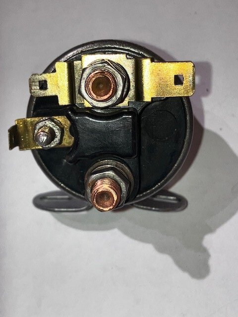

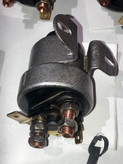

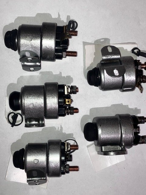

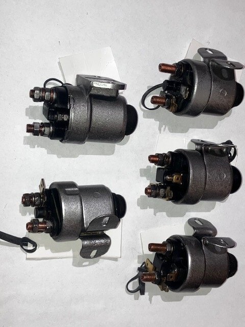

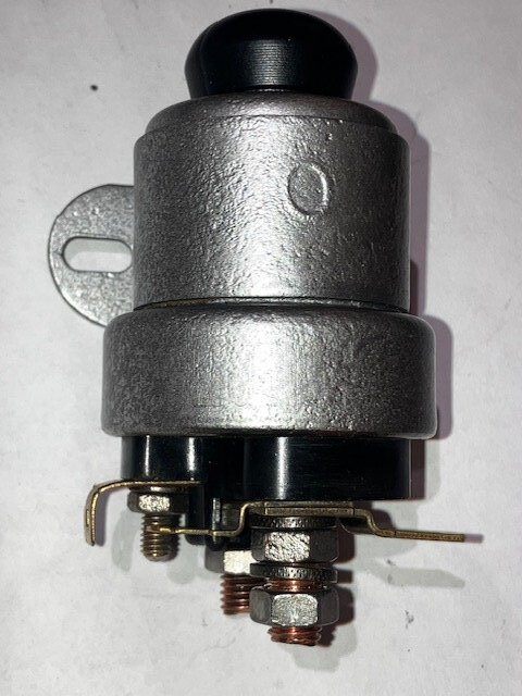

Tony - sounds like you need one of these! All have been refurbished and tested, albeit not taken apart as this is not possible, butIMG_3472.jpg.06d01df8798550fd4ca211d771120e20.jpgIMG_3473.jpg.738d4283fa5315ef95166eda97d14056.jpgIMG_3474.jpg.6725f1a986e30cce8a12c685300ed029.jpgIMG_3476.jpg.f7eab07de70c7e2340b6fd33e3fccdcd.jpgIMG_3477.jpg.501c52525774ccef9b4efff7436600c0.jpg operate when livened with a satisfying "clunk"
One of the ones in the photos is slightly different to all the others as it appears to have a cast body - I'm looking for £30 if you are interested
Cheers Rich C-R

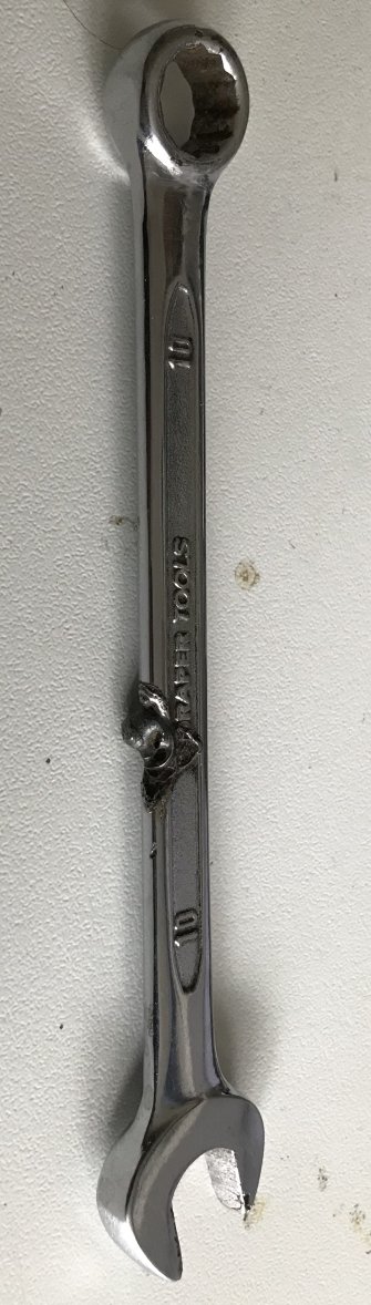

Or write off a perfectly good screwdriver. ;)
