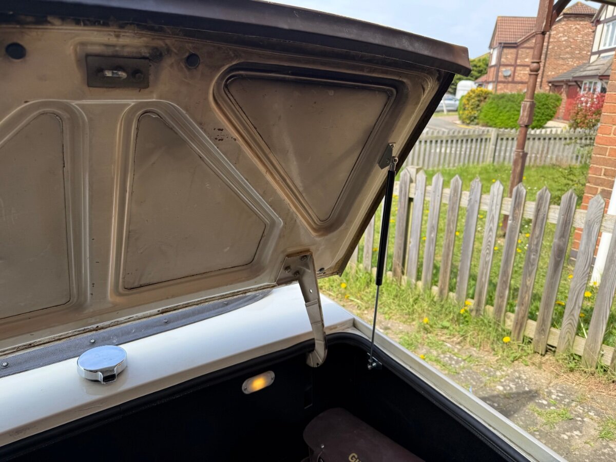

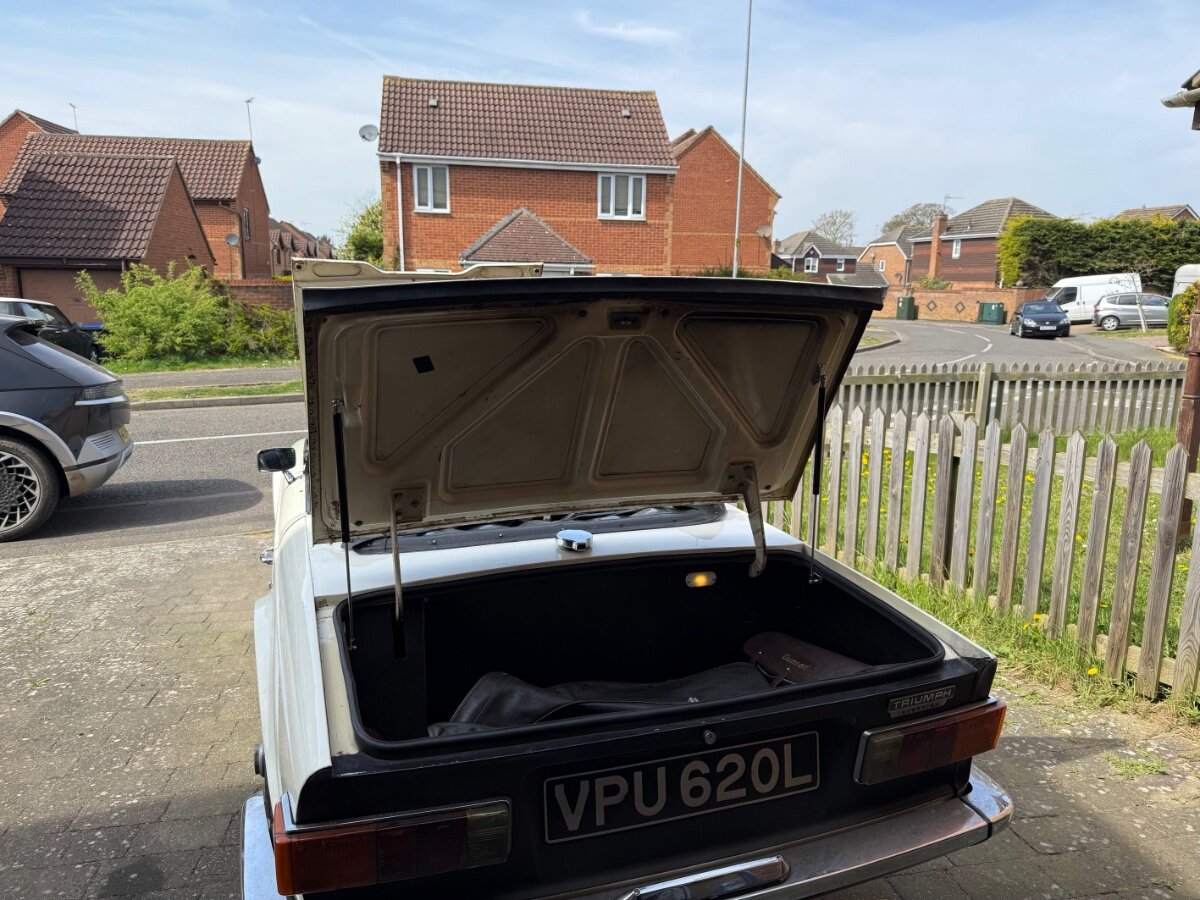

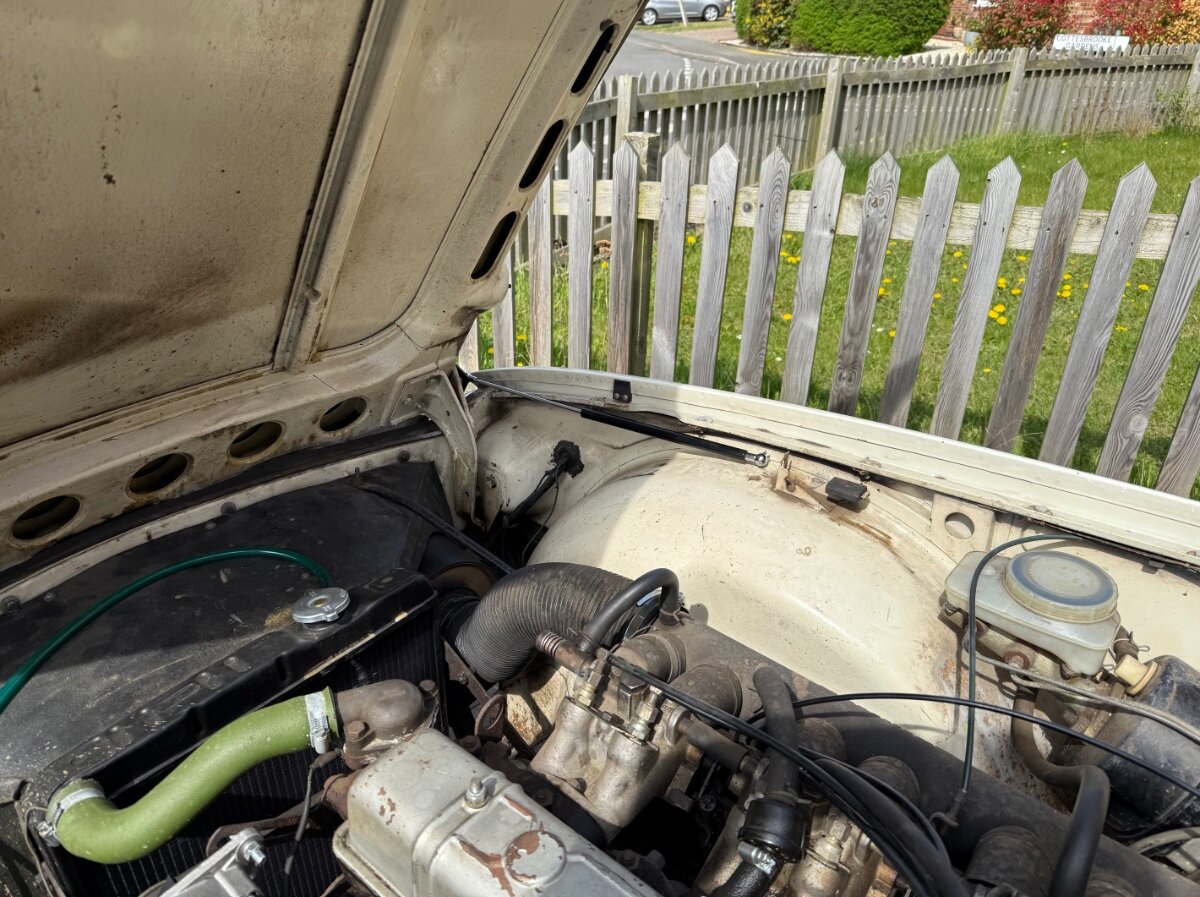

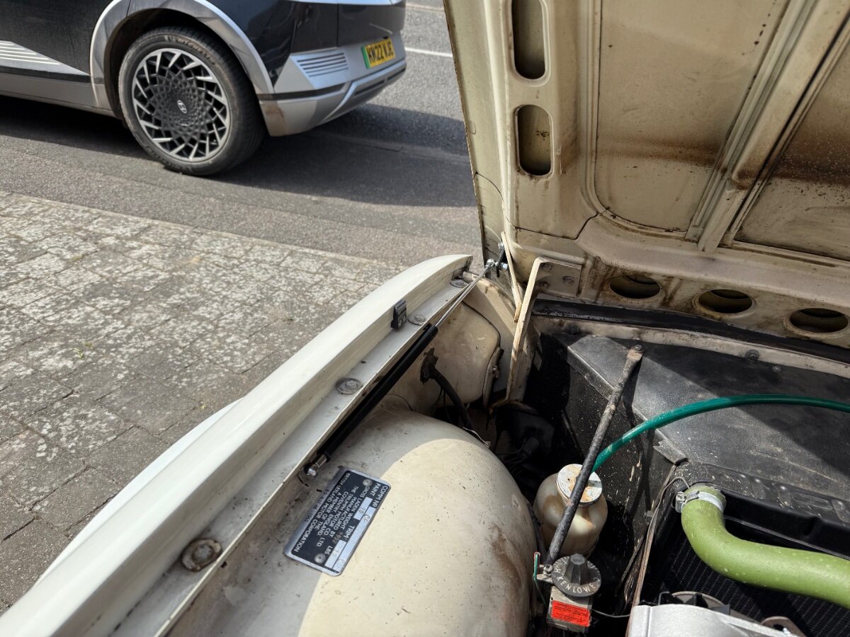

So my kit has just been delivered. Final mile shipment was via Evri… and I’ve not been charged any additional import costs (so far - the courier didn’t ask for any additional payment on the doorstep. If there are any I guess it would be an emailed invoice, but nothing has arrived as yet)
So total cost so far to me to get it landed here is $199.56 (£161.56 @ PayPal’s rate of £1 ~$1.24)
So they work, and work well. The instructions are clear, and it’s probably an hours job max to do both the boot and the bonnet.
