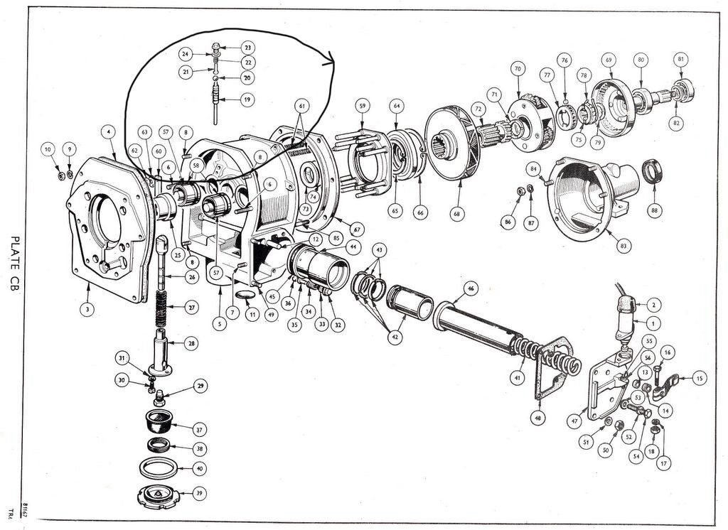

BlueTR3A-5EKT Posted April 16 Report Posted April 16 (edited) Could it be dirt in the spindle valve. The one under the cap with the ball and spring. The spindle has holes in it which are quite small holes that direct oil under pressure and therefore will allow pressure decay when disengaged. Items 19 onwards circled in image. Edited April 16 by BlueTR3A-5EKT Quote
John Mellor Posted April 26 Author Report Posted April 26 Thanks all. Found a Laycock manual describing perfectly what happens with partially obstructed spindle valve. As oil pressure reduces od is released. Change into od at 4k rpm wasn't that quick so will try a few more before going for the spindle valve. Guess that means transmission cover has to come off. Sod it, knackered knees and shoulders make it difficult. Guess my decision to sell this year is the right one. John Mellor Quote
