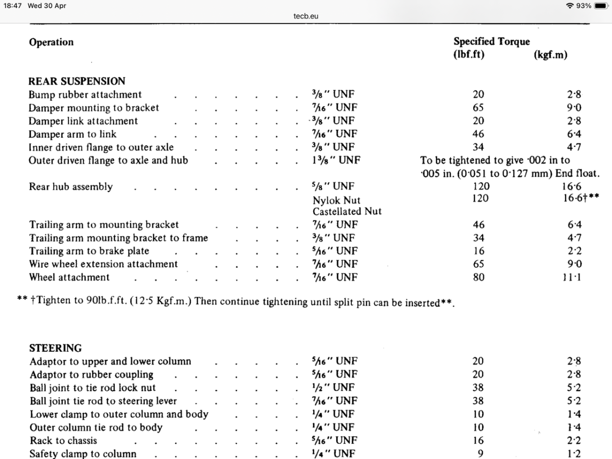

BlueTR3A-5EKT Posted April 30, 2025 Report Posted April 30, 2025 (edited) Thankfully I posted a link to the Brown Bible in the technical section of this forum In the “ Bonanza” Sadly not of use to those with non standard parts. here is a page grab. Edited April 30, 2025 by BlueTR3A-5EKT Quote
Waldi Posted April 30, 2025 Report Posted April 30, 2025 I have Panasport wheels (which are also alloy), and asked Panasport their required torque. The answer was to use the value stated in the WSM. Be aware these values are for not-lubricated nuts. Waldi Quote
