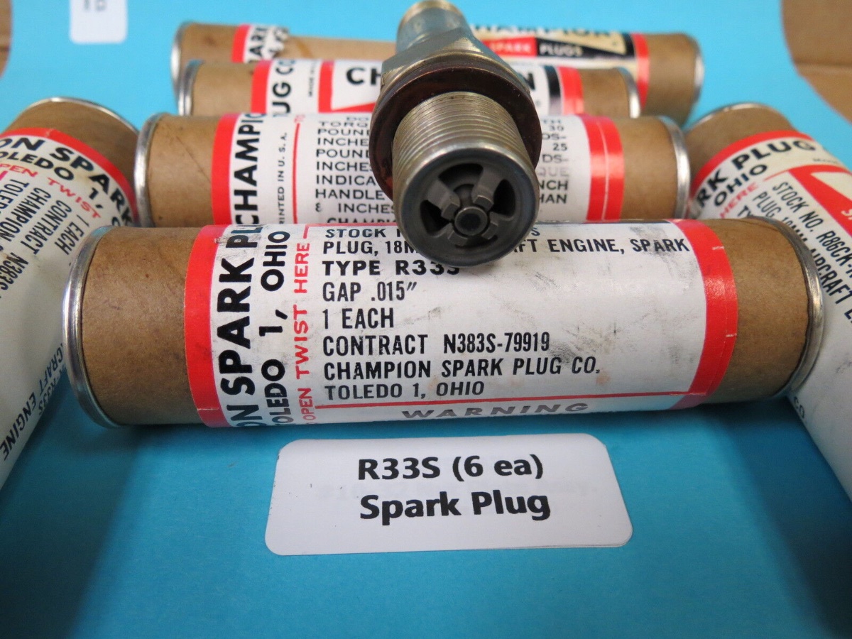

BlueTR3A-5EKT Posted February 26 Report Posted February 26 Last time I touched plugs like that with 4 earth contacts I was fitting them to a Pratt and Witney R1830 Quote

stuart Posted February 27 Report Posted February 27 11 hours ago, BlueTR3A-5EKT said: Last time I touched plugs like that with 4 earth contacts I was fitting them to a Pratt and Witney R1830 I take it they came ready gapped then? How would you gap a 4 electrode plug? Stuart. Quote
