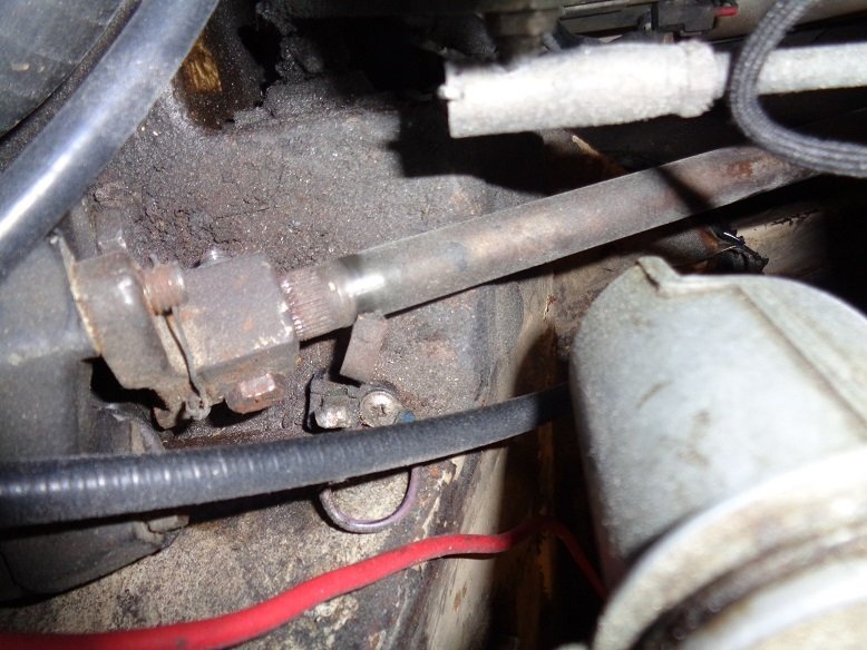

tim hunt Posted April 16 Author Report Posted April 16 10 hours ago, Richard B 2.5PI said: Tim, Have you got an earth wire on the steering column U/J's connecting each side of the U/J? Yes and in answer to Roger I also have a supplementary sprung contact permanently earthing the lower steering column to the body, see pic. As for John's input the horn never operates inadvertently, my problem is as described, the horn push only operates the horn through approx 300 degrees of steering wheel rotation. Thanks all. Quote
stuart Posted April 16 Report Posted April 16 1 hour ago, tim hunt said: Yes and in answer to Roger I also have a supplementary sprung contact permanently earthing the lower steering column to the body, see pic. As for John's input the horn never operates inadvertently, my problem is as described, the horn push only operates the horn through approx 300 degrees of steering wheel rotation. Thanks all. Have you checked that you have continuity for 360 degrees, it maybe you have a short horn pencil and if the steering wheel hub casting is slightly out of concentric it’s not actually contacting for the missing period Stuart Quote
john.r.davies Posted April 17 Report Posted April 17 13 hours ago, tim hunt said: Yes and in answer to Roger I also have a supplementary sprung contact permanently earthing the lower steering column to the body, see pic. As for John's input the horn never operates inadvertently, my problem is as described, the horn push only operates the horn through approx 300 degrees of steering wheel rotation. Thanks all. Ah! My mistake. Then suggest removing the steering wheel and applying engineers blue, or a felt tip, to the contact strip. After reassembly, testing by turning the wheel and then dissemble again. You will see if the 'pencil' is contacting the strip all round. If not, then there is some distortion in the whole assembly. If it does make 360 contact, then the problem is elsewhere. John Quote
