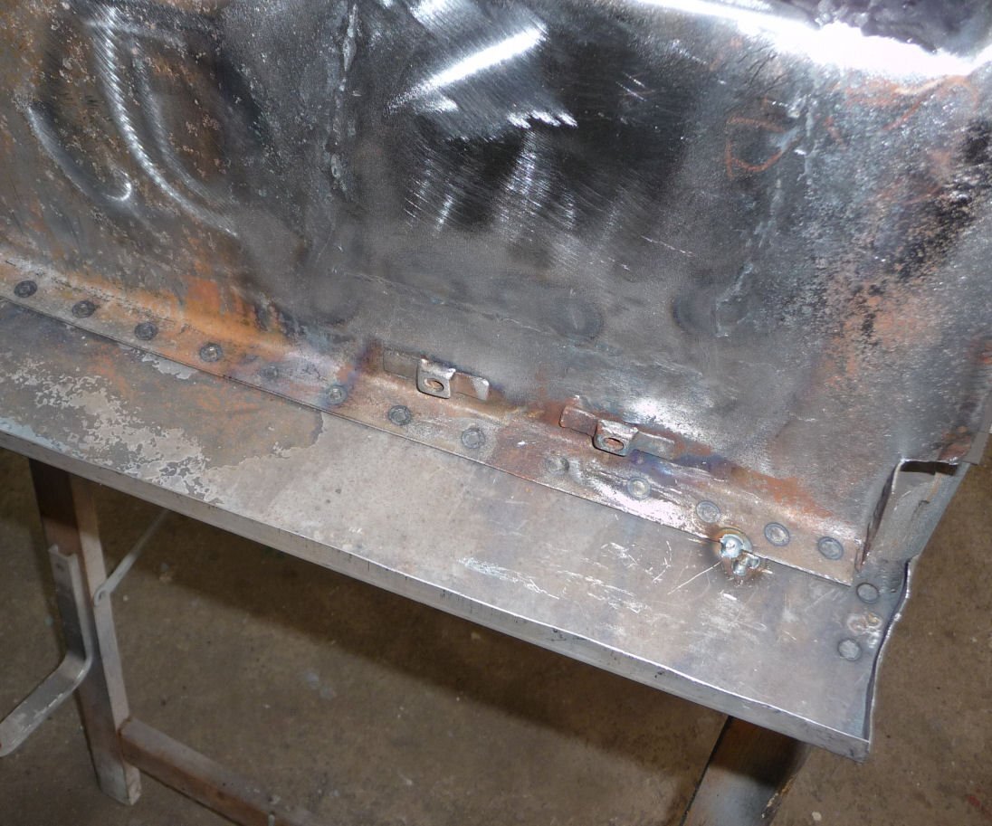

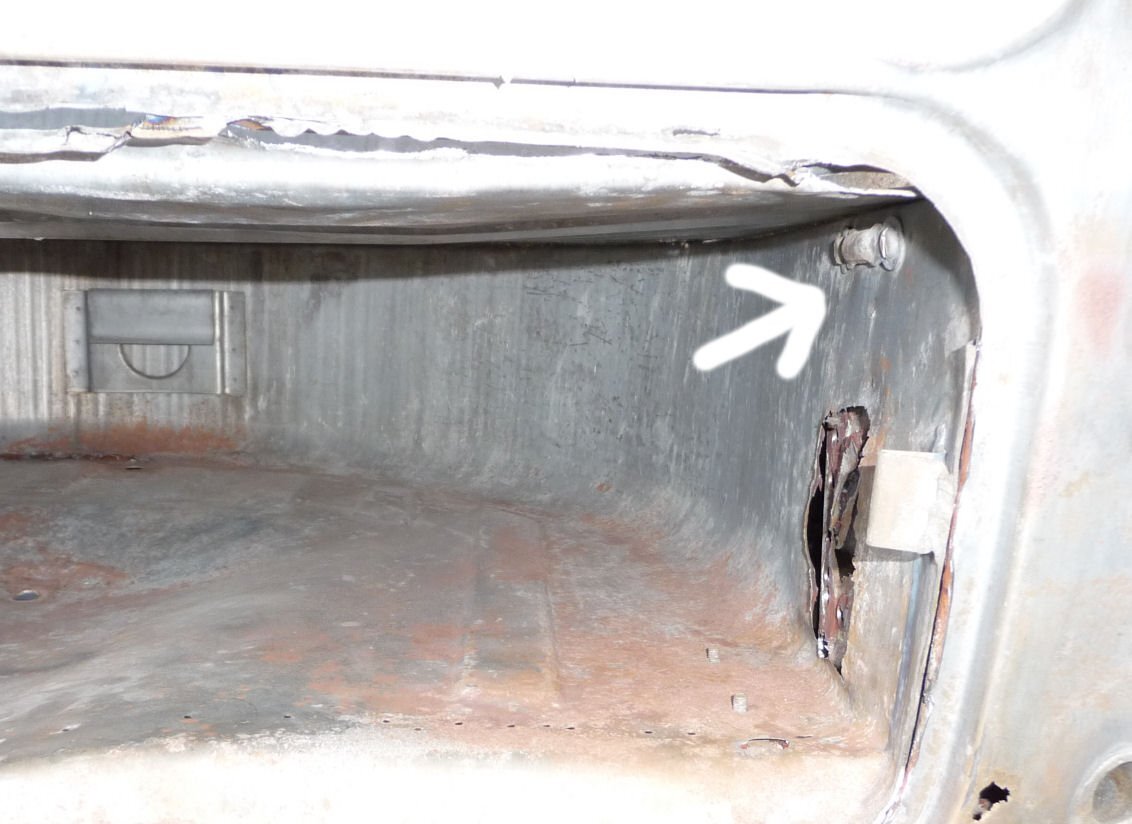

Black Forest TR3A Posted April 28 Report Posted April 28 Hi Richard, there should be two cage nuts behind the holes (see pics). Original Screws were slotted and pointed. Quote
Black Forest TR3A Posted April 28 Report Posted April 28 The front one is accessible, the rear one isn't. (Just to show the prob to other readers.) Quote
Richardtr3a Posted April 28 Author Report Posted April 28 Thanks for the reply and the pictures. I was at a TR club meeting yesterday and there were some TR3A . I was able to inspect three and none had the bracket fitted or any signs of captive nuts. Your picture makes it clear and I will now be looking for a correct thread Nutsert. If it is available and still called Nutsert. Thanks Richard & B Quote
